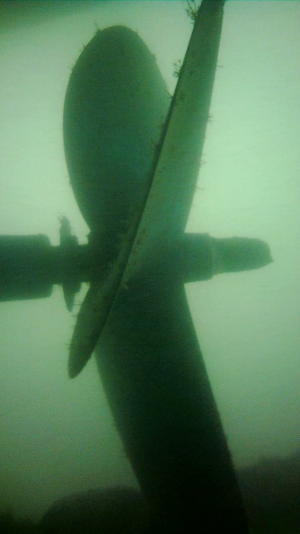

Actually, some have a longer focal distance but not always easy to find that out from the selling site. Mine works well for the prop but I can't find it for sale anymore 😕 despite the low rating I found it was good and am still using it 7 years later Amazon.co.uk

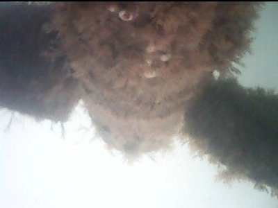

I tape to an extended boat hook to view prop anodes. Usually shows the fouling too 😐
All works well enough as long as you keep the top end, where the electronics are, dry.

Yes, lots of murky water on the East Coast. The river Crouch is far from clear but this was taken without x-rays 😁
Must have been a clear day on the crouch! I can barely see the rudder on my boat from the pontoon at essex marina
I get the best pictures on a falling neap tide, on a bright day and without the borescope illumination turned on. With the integral illumination the light just reflects off the silt that is in suspension and spoils the picture.
