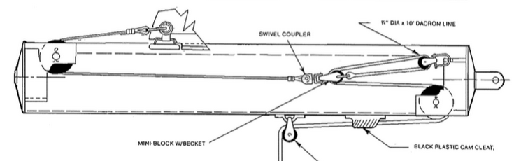

Drill out the rivets and use boiling water and a rubber mallet to remove the end fitting. With luck it will come out easily but if you leave it a few more years it will be even more difficult to remove. There are many possible internal arrangements and you will not know until you have a look. A common one is in the diagram below. It might be better to remove the gooseneck end first as the tail of the purchase might be attached there.
I had a 4:1 purchase with double blocks that I replaced with a 4:1 cascade that was much smoother to use. Refit the end plug with grease so it will come apart easily next time. I used large self tapping screws instead of rivets as I will probably open it up again in another 10 years.

thanks - I'm not quite sure I understand the layout - can you sketch?

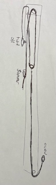

This is what I’ve got. End fitting came off easy enough. Seems odd that the “3rd” end is just tied off on the bottom of the boom. It’s just round a pin , which I suspect it’s supposed to be tied to, but access is tight. I could possibly add a cascade to that and lead it back.
So, all you have there is a 2:1 and as it cleats on the boom and is not led to a winch is a bit mean. You would be lucky to adjust it under load. William's suggestion is rather than shakling the line to the clew, pass it through the clew ( or a pulley attached to it) and make it off to the end of the boom, giving you a 4:1. My suggestion is to maybe set up a 4:1 between the clew and the boom end, giving either a 8:1 if you retain the pulley in the boom, or 4:1 if you get rid of it. Plenty of people never adjust the outfall in which case just tie it off with a piece of sting
