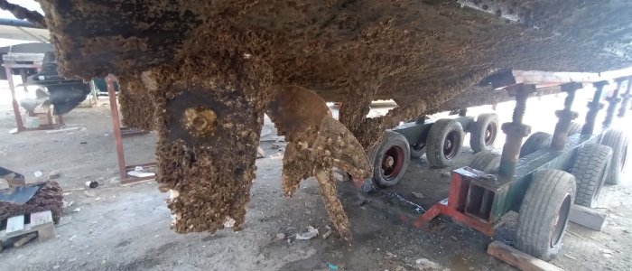

Firstly, Derek is a YBW forum member of long.
You might have spotted him on his boat flying his drone.
The build up on JW was a whole year.
Yes, the barnacle growth around SCM is particularly aggressive.
Over the years, we have learned how best to deal with it.
You say that berthing at SCM is very attractive - yes it is.
Even more so when you realise that lift for both the boats was complementary - we get one free lift each year.
Usually, I lift the boat and "block off" for a week in April/May for her annual maintenance.
Then again for a quick lift later in the autumn just before we go off cruising - that way, we have a nice clean boat at both ends of the year.
Some people paint/antifoul their propellers but I find that the paint doesn't stick to the propellers when you use the boat.
Well, most of the paint doesn't stick - the stuff that does stick is a PIA to remove later when you have to re-paint them.
So, my plan is not to use any treatment at all.
Usually, I polish the props and use acid treatment a couple of times a year.
That way, my props are in better condition than if they were painted.
The lift, pressure/acid wash takes about a couple of hours so no big deal.
It is also a great time to check the boat.
During the lift above, I noticed that one of my stern thruster anodes unexpectedly needed replacing so that was done - there and then.
I also changed the trim tab anodes in that lift.

So this year the barnacles have grown a bit bigger than usual.

Don't be put off by the marine growth - it is all manageable.

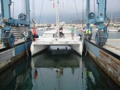

The boatyard lifting facility at SCM limit is mainly apparent to catamarans.
Some can just scrape into the dock but most have to go over to the town boatyard which is privately owned so that yard will do the work.
When I say "scrapes in", I mean it - this is a regular visitor to our boatyard - only the carpet lining to protect it.
That said, this is the largest one that the staff will lift because they KNOW it just fits.
Pointing out the camaraderie - all those on that boat are good friends - in SCM it doesn't matter if you are a yachtie or a motor boater, we all get on so well together.
Often meeting up in town or going out together.
It is a really friendly marina.
The Phantom that followed me in had to wait for the staff to change the slings over.
You will see from the video that JW uses two double sets of slings - the Phantom only uses single sling set.
Also, the staff always wrap the slings with shrink wrap on each sling before lifting.

Strewth, I had forgotten how fast serious fouling builds up in the med. I once left in the med, a UK based boat for 6 weeks with no antifouling coating on the props and it had to be lifted to get the crusties off. The props were like box hedges.
Years ago we had a boat in Kip Marina (near Glasgow) for a year. It was lifted for inspection and there was three, yes three barnacles on the entire boat!
