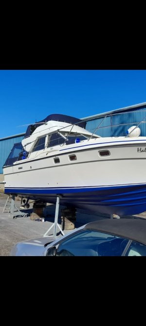

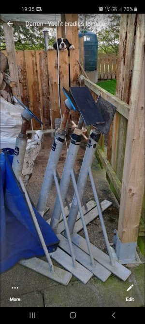

Attached are pics of the boat on the yards stuff last year, and the legs I can get locally.
Boat weighs about 6 tonnes.

31ft. The set up in the pic is how the yard support her every time she has been out. From what I have read, 3 stands on each side would be preferable.
There is a 3rd stand under the keel at the bow that you cant really see in the pic.
Most of the weight goes through the keel blocks, the props are only there to stop it falling over. TBH I'd want more keel supports and the stacks of blocks look a little precarious.
She seems to be sitting very high. Was that requested to make antifouling easier? My marina sits the boat on two blocks so the keel is around 12-18 inches off the ground.
My marina use steel barrels and wooden wedges instead of those supports and I’ve never seen any problems.

No, the boat goes from a crane to a trailer and I think it is to do with the height of the trailer. I just need it high enough that I can remove a shaft if needs be, so a little lower would certainly do. Roger on the ratchet straps.
Learnt from the yard that does our boat, don't make the props too tight as the boat settles a little when the strops are totally loosened. They screw the props so just touching the Hull. Then check that they feel solid once no load on strops.

I've heard of barrels collapsing, think most yards use the adjustable props now.
Grand so. I think I will aim for as low as possible. I need a bit of room incase I need to pull a shaft out but I reckon I could lose a few inches compared to above. Prop stands are on the way. Probably three sets of blocks underneath. Cheers for the feedback.
Agree about the keel blocks being precarious. That arrangement may work for "side wind" loads but is terrible for "headwind/tailwind" loads. The keel blocks need a decent square footprint not a railway sleeper linear athwartships foot print.
Just to add fwiw on here I have seen yard operatives tap the hull at the keel and place the keel supports under the more solid sounding areas…..just sliding them back / Fwds a few cm before lowering the boat down .Dull thud instead of a hollow sound .
Idea being rest it on its bulkheads and heavy built sections as opposed to thin ( by comparison) hull sections .

My 32 which is a similar weight usually gets sat on two sets of blocks stacked about 2 high. There is then at least 3 boat stands down each side. If out for more than a quick antifoul I would opt for 3 sets of blocks.

Ordering some sleepers as we speak and have managed to get hold of 6 stands, with 4 more potentially so all good that way.
