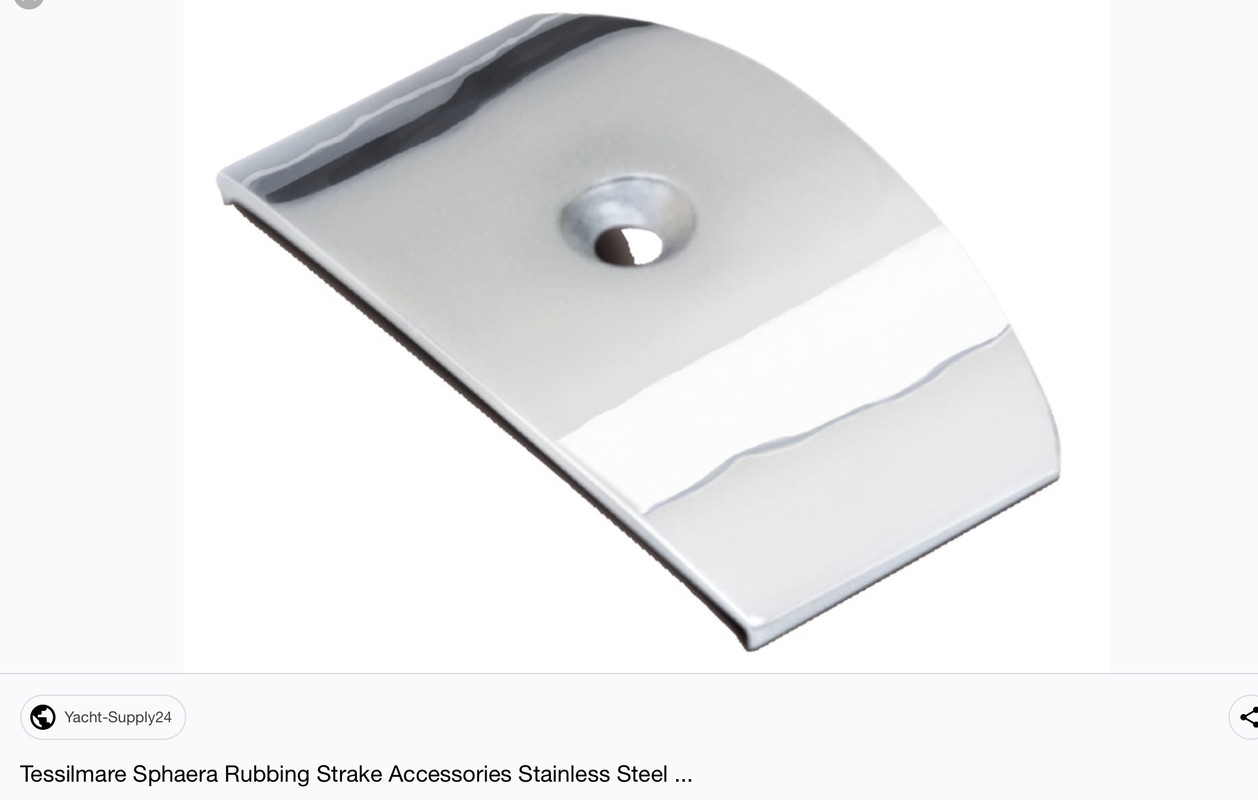

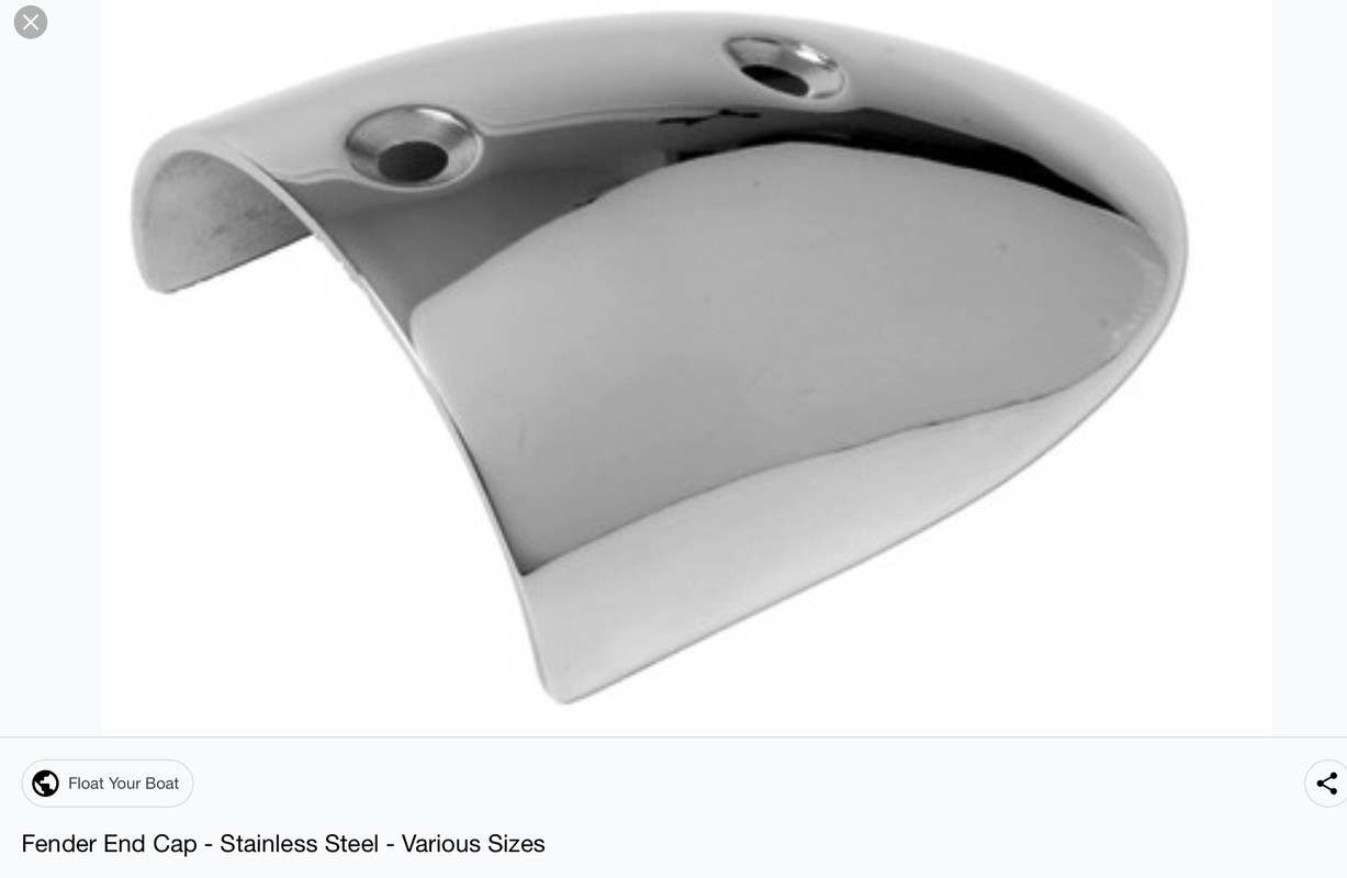

Ok, thank you. how would I install it with the two-part system if the rub rail doesn't already have drilled holes or if there is no filling strip. can you buy it separately? Is there also a way to do it without any screws or bolts and with epoxy or sealant instead?
fisherman
2 Dec 2005
19,675
Far S. Cornwall
Google shows a system with pvc strip inside, and fixings that incorporate a plug for the hole in the outside profile, but it uses screws. What glue is going to stand a knock up or down when coming alongside? How about a wood strip with a rebate routered out for the D section to sit in?
