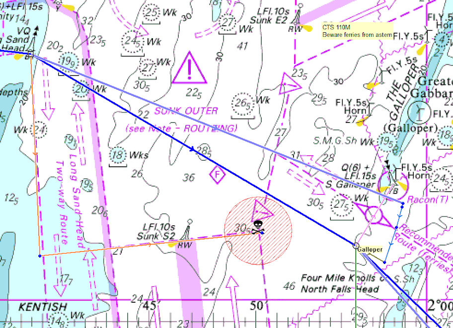

Let's have a detailed look at how I've dealt with the Sunk TSS ...
Navin (North Sea Passage Pilot) would have you head South from Long Sand Head until the Sunk S2 buoy is abeam and then turn hard-a-port to cross the top end of the TSS at the required 90 degree heading. However, this adds fully 4 miles, and therefore a whole hour, to the passage. It is the ultra-safe option as it totally avoids the Sunk Outer Precautionary Area and stays well to the South of the Harwich - Ostend ferry traffic.
I'm not going to do that! There is nothing in the rules to prevent a yacht from transiting the precautionary area on any heading the skipper chooses. So I'm going to set a zone alarm on the chart plotter on the North East edge of the TSS, to warn me if I should get set too far South by the tide, and a guidance waypoint which I shall call "Galloper". This will give me a cross track error readout which in turn will tell me whether the tidal set and my leeway are within acceptable bounds or whether I need to adjust my heading which I estimate needs to be 110M for this leg
Because I'm dog-legging slightly North of the direct track, my heading from "Galloper" isn't going to be 130. It's actually, to be pedantic and according to my calculations, 138T (with not much magnetic variation about at the moment. 21 minutes West if you must know which is kind've irrelevant really). I round up or down to the nearest 5 degrees anyway 'cos nobody can steer that small so that comes out of the box as a heading of 140M

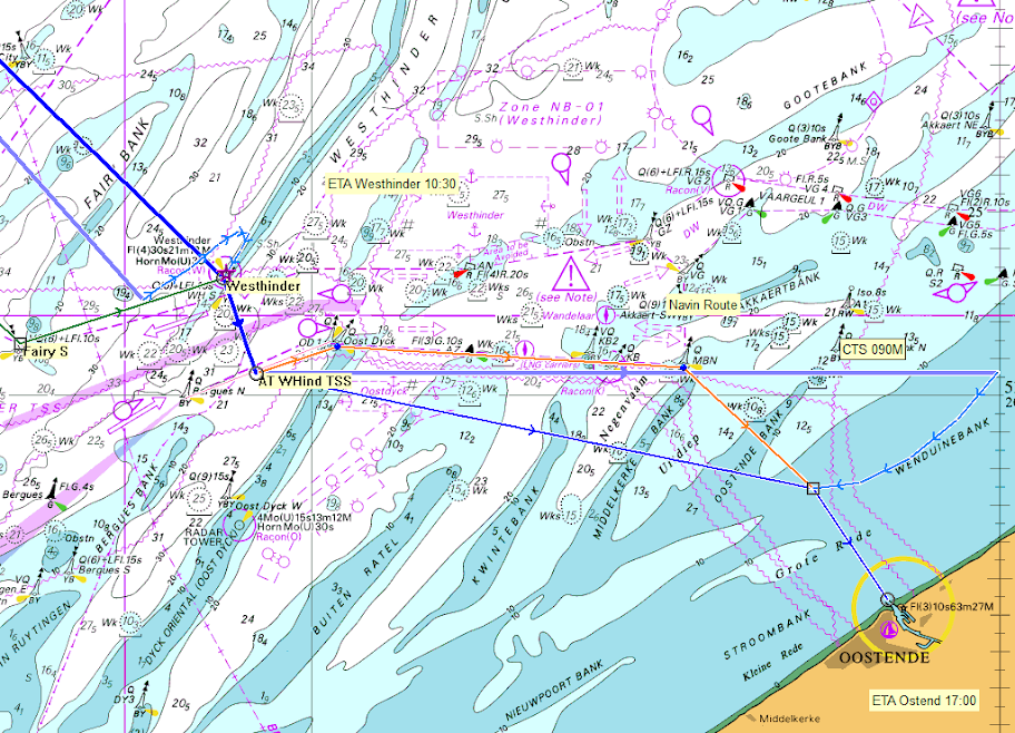

The final screen dump (and I apologies if these are too big for your screen but any smaller and they'd have been useless) is a detailed look at the Ostend end ...
Leaving the West Hinder Light to Port, we head at 160M to cross the TSS at 90 degrees to the traffic. We can use either the pre-programmed waypoint or, if you like old fashioned methods, a clearing line between the North Cardinal buoys at either end of the TSS (all of which should be visible through binocs in good vis) to determine when we've crossed the shipping lanes.
Then we have a choice to make. Navin would have us skirt close along the Southern edge of the shipping lane. At this state of the tide, we'd be fighting it all the way and I suspect it would be somewhat of a drag, especially under sail. Alternativey, I can see no good reason, in decent weather at any rate, not to lay a course of 090M which allowing for the tide setting to the South West now would land us fairly directly in the vicinity of the Oostendnake E Port hand buoy (indicated by the square symbol but not shown at this chart scale)
From there' we head directly into port, being aware of the tidal set to the South West across the entrance.
Why not head straight in you ask? Well there's marine nature reserves all over the shop and whilst it's very clear that there is no entry to the inshore zone, the rules on transiting the next bit further out are vague and also not available in original form in English. For the sake of a mile or so, best to stay clear methinks.
ETA Ostend 17:00. Yes, I'll have a bier, thank you very much!
