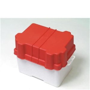

You could get a reasonable sized plastic box with lid to sit battery in ...

I kept the starter battery and all of the wiring connections inside a basic battery box.
