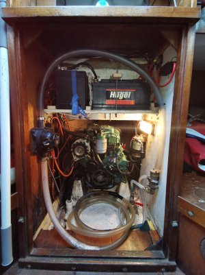

It seems like a good idea to fit an electric bilge pump. Currently there are 2 manual bilge pumps. One operated from outside in the cockpit. The other mounted on the bulkhead inside the engine bay, so I have to remove the steps to get to it. Its a most unsatisfactory arrangement in many ways!!
I'd like to fit an electric bilge pump to ursurp this bulkhead mounted item, and fit new pipework exiting through or near the stern.
What type of bilge pumo would be best? Its a 26ft grp cruiser/ racer
Here's a pic of the engine bay.

You could simply fit a diaphragm pump in line with the existion manual pump in the engine bay
If you wish to have a high capacity bilge pump you will need a centrifugal pump but this needs fitting in the lowest point in the bilge

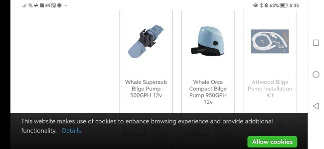

I was thinking about something like one of these? I'm guessing they'd be the diaphragm type.
The middle one looks like a centrifugal the fist one is designed to fit directly in narrow blige
These may require extra piping but looks like you need access to the deep bilge
I know the Gulper 320 is a diaphragm and can be fitted inline with your existing manual

I never realised there was so much choice! We only have a very shallow bilge, would that influence the type/model To choose?
The middle one of 2¿ 🤔. Now I'm confused.🤣
