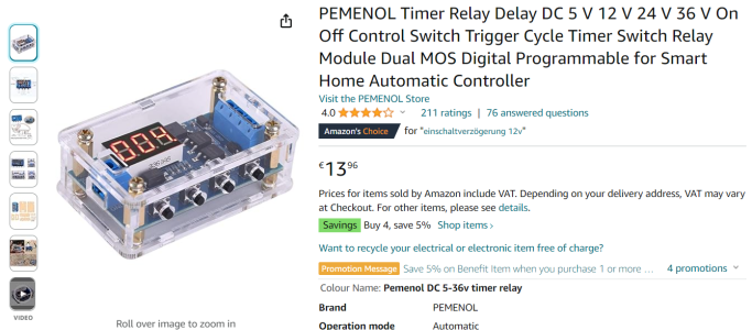

Hi all.
I am running twin petrol engines and want to be safe, some folk say i shouldnt need them etc etc but i want one. So getting one.
I want to fit a timer on the ignition so engines cant be started until the blower has been on for a set time.
What timers can you suggest for this job ?

Yes I have a blower but it's the timer I am looking for. So I can turn on ignition then its on a timer before I can turn the engine over. I see some small gadgets on ebay but unsure if they are what I need.

Good idea but... You won't be able to start immediately, even in case of an emergency. Like drifting into some rocks and wanting to move away pronto.
Get into a good habit: Start the fan and open the bilge hatches for a swift visual inspection (oil check..?) in good time before starting.
Add a timer to keep the fan running after shutting ignition off.
You may even add a solar-driven fan to ensure ventilation even when parked.

Good point there. Never thought of that when in an emergency.
So just fan on a switch. Better for safety. Be easier enough to get into a routine. I will be doing a check anyway before setting off. You never know whays heppend while away.
Maybe me being over cautious.

I think ill just make life easy and connect the blower i have to a switch and use it manually.
There are good amount of vents to feed the engines.
thanks folks for the elp :)
