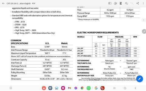

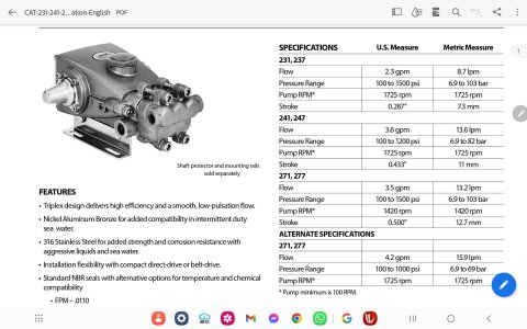

The 277 and 247 Cat pumps can both use a 1.5kw motor. They can be used with a couple of 21" membranes all the way up to 3x40". From about 70l/hr to 200l/hr range of output.
If you run them from a belt drive, I am sure you could slow the pump down to use less hp on a smaller motor for low output. For me, we want the maximum output for the system to give is a high litre/Watt. It uses less power and we have less run time on the system
geem
27 Apr 2006
8,043
Caribbean
This might helpScreenshot_20230722_163721_Adobe Acrobat.jpgreceived_1207796733223592.jpeg
