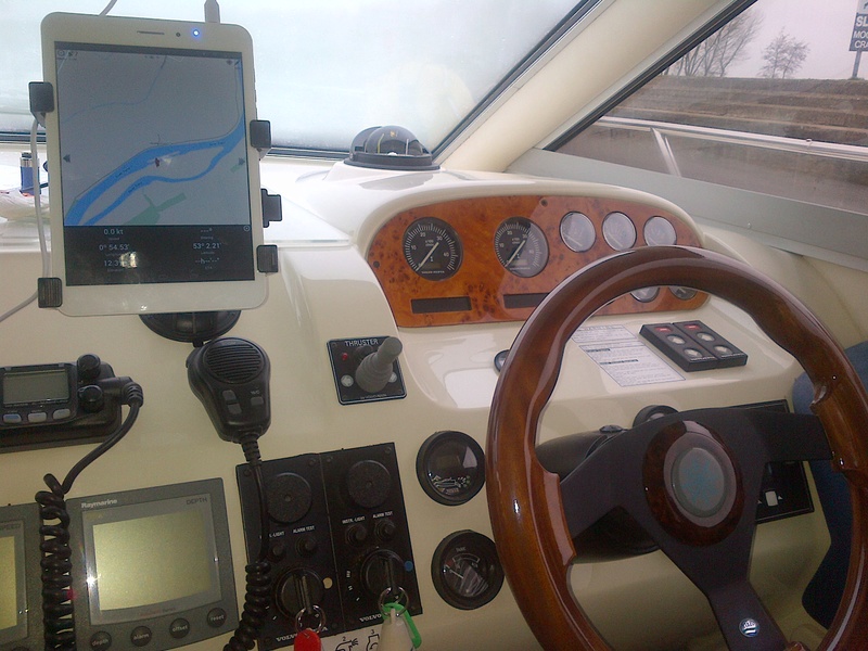

I have flybridge and have the MFD at the upper helm.
I drive the boat from the upper helm most of the time - only retreating to the lower helm when absolutely necessary.
I use a tablet as a repeater at the lower helm . The tablet screen is not daylight viewable, nor is it waterproof. But it is okay as long as the sun is not on the screen.
I have used some double sided self adhesive velcro to fit the tablet to the dashboard - which is cheap but also far more successful than the suction mount shown in the picture.
If money was no object I would have a MFD at both helms .

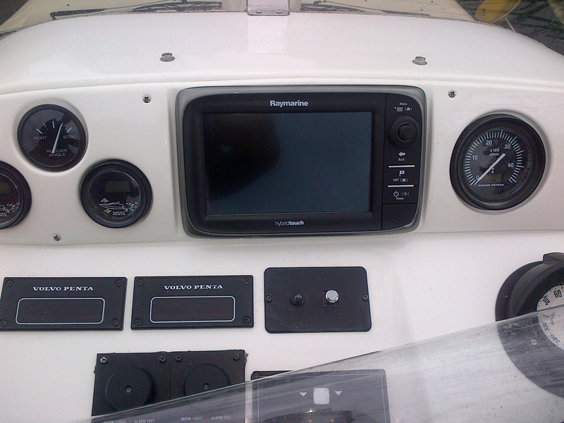

Just look at Raymarine recommendations for transom transducers.
And that's just the first example which I found with a quick search, but I'm sure to have seen similar instructions in the manuals of several other brands.
My Garmin instructions say more or less the same thing but as I said in an earlier post the sonar performance won't be critical for me so I'm going to chance it.
