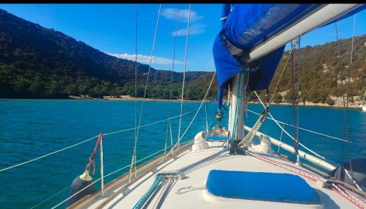

I have used Sandtex that worked reasonably well on a previous boat. Five years ago I did my Sadler decks in white International Deck Paint. This is in Greece where the air is surprisingly dusty and often deposits Sahara dust on everything. Despite long layups the decks and coach roof Screenshot_20241109_154833~2.jpgstill look pretty good.
