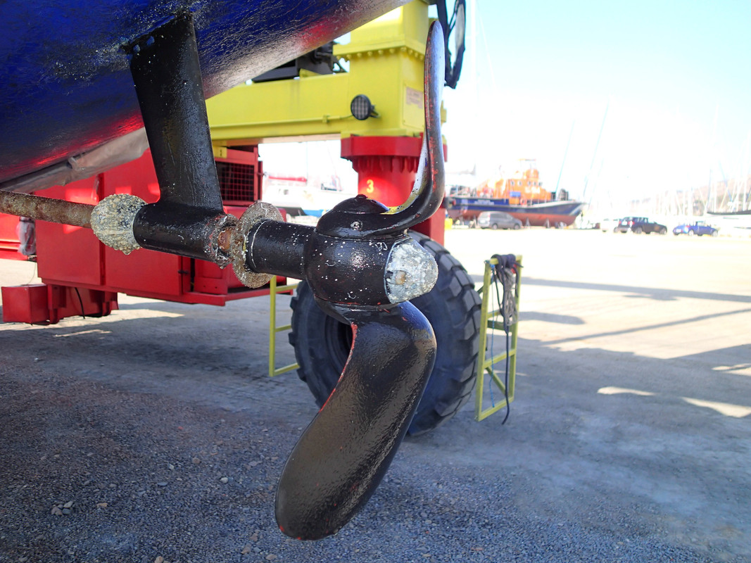

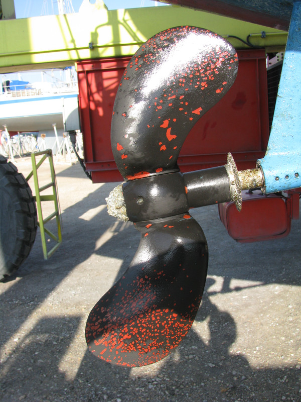

This photo shows my first year using Hammerite primer with Velox on top. this was 2012, at which time Velox recommended four coats. At the end of the six month season the Velox had chipped at the typical cavitation areas, possibly to some extent due to poor adhesion.
By 2018 Velox only recommended two coats, which reduced the chipping considerably. The Hammerite is the original two coats, simply rubbed down using 180 grit paper before two coats of Velox.
In each case these photos are after six months afloat in Greek waters and taken before pressure washing. I am still using the original small tin of Velox, about half left now.
