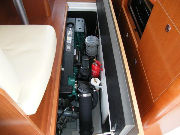

Have you looked into access to the engine for daily checks? It was a big downer for me when I seriously looked at and trialled an Antares 30 last year.
Do you know which model year you trialled, it looks like they improved engine access by allowing the starboard engine hatch to open first, which means the seating can stay put?

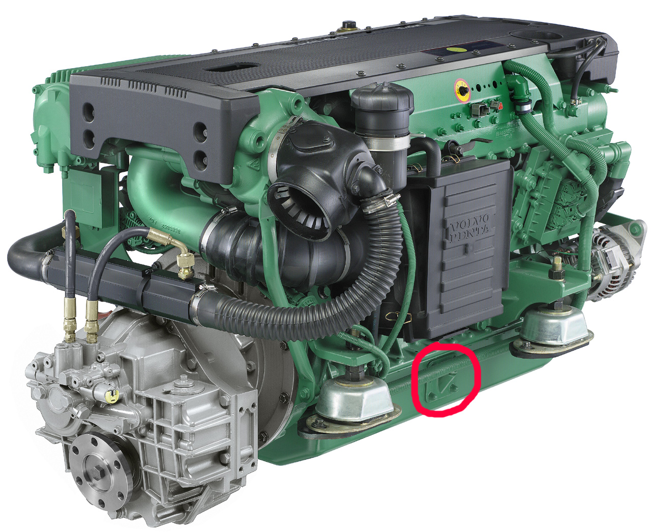

I also spotted the oil dipstick has a service option on the starboard side of the engine, so I was going to pay the Volvo engineer to move it at first service if it makes daily checks easier.

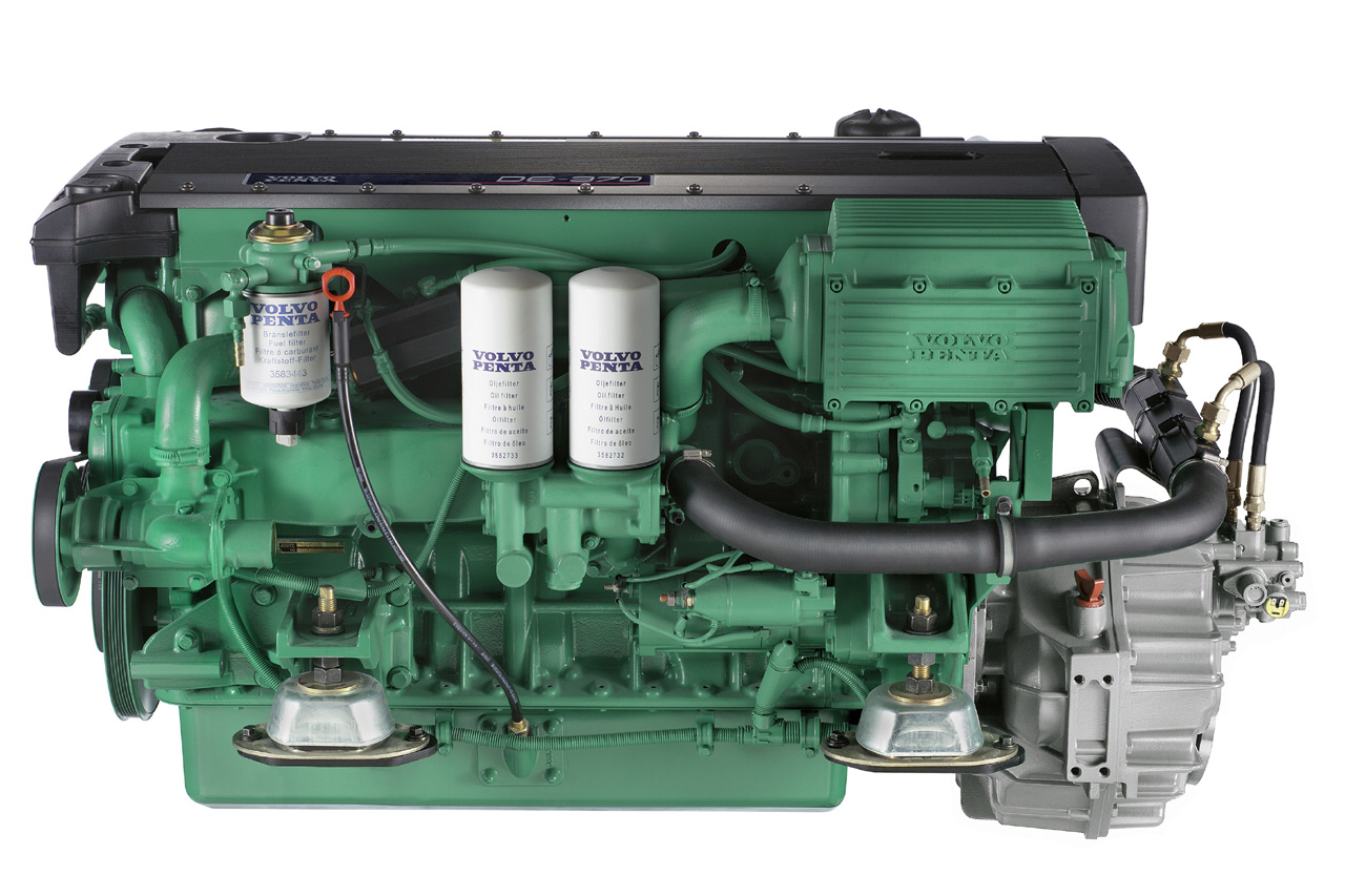

Standard dipstick on port side
Blanking plate to allow starboard dipstick
We have one, 3 years now.Tank in Lazarette is fuel! Can't personally see a problem with checks as you just lift the 1/2 floor section in the saloon & water filters & dipstick (it has 2 One is a small one on this side of the engine -a bit deep & the other does required a bit more furniture movement) as are fuel filters.We have a Yanmar so can't comment regarding D6 fitment. I fitted another plotter on the flybridge,there being provision for it power & space wise, although the cable between the 2 was shall we say an interesting run! Only 2 240v outlets & they are french type! I teed in another double UK in the forward cabin & fitted a TV above them on the bulkhead. OPTION NOW FOR SINGLE/TWIN NOW but we wanted a single to keep costs down, but bow thruster is ESSENTIAL!! PM me if you want a chat.Boat in Essex

I'm curious about the raw water flow in above picture. Raw water flows left to right (in that picture) thru the black gearbox oil cooler atop the gearbox, then it runs up the convoluted pipe into the main engine exhaust. But it enters the exhaust really close to the turbo, not after an elbow. How does the turbo not get splashed with seawater in that picture?

Does the water flow in and around the exhaust elbow a bit like a water cooled manifold, then exit around the outer circumference of exhaust elbow exit?

The dipstick needs handing, its madness that they dont do this as standard. The only other real fault with them is very tall people cant get comfortable at the upper helm.
