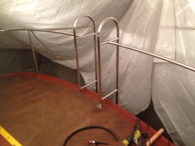

I have been bending 1" stainless and the finish is good - a solar arch with 90 degree bends. Thought I would point anyone thinking of bending in this direction:
(though it doesn't give info on use, despite the title).
It takes a goodly amount of force - I was using a 3m cheater bar, but once it starts moving it does get a bit easier. Slight flattening as you would expect, but nothing obvious.
I got the base welded to a steel channel so that it would fit into a vice. I ended up on the ground when the tack welding gave way. The amount of force involved means you need a good welder and a few inches of welding. Stainless rods to weld steel to cast iron, I was told. Or bolt it to something.
I used to pay £10 a bend but no-one I could find in the Edinburgh area does it, so a tool was purchased. I think I paid £90. 9 bends worth. Next task is a better shape for my sprayhood, but that is just with 19mm stuff.

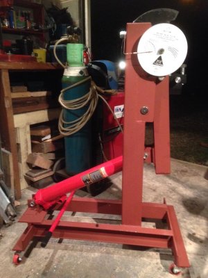

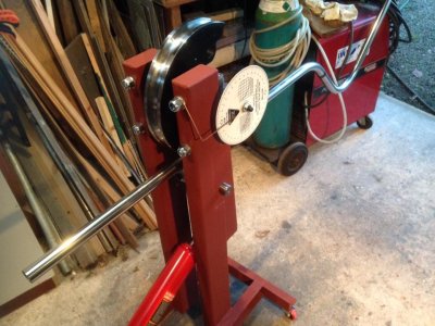

This was my homemade hydraulic bender that I used for bending the 11/4” thin wall SS tube on my project. I bought the die set from Stakesys and the long stroke hydraulic Jack off eBay. The white disc is an engine timing disc so marked up for degrees. Capable of doing full 180 deg bends.

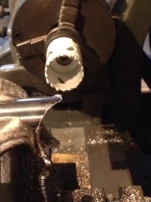

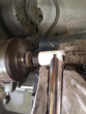

You can use a tube notcher for prepping the ends of the tube. I have a small Myford lathe so I fitted a vice onto the cross slide and used a hole saw on the chuck. A bit tedious to get the centre height of the tube correct, but once set……. Also, expect to go through a few hole saws, as they regularly lose teeth! You can also adjust the angle of the vice to suit your fabrication requirements.

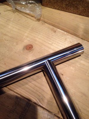

Welding a T joint is not as straightforward as you might imagine due to distortion of the straight top tube. If you just go ahead and tack then weld the joint shown in the photo, once welded, the top straight tube will end up bent into a slight v with both ends bent downwards toward the other tube. To prevent this, I made a jig which clamped to the upper side of the top tube and pre bent the straight tube away from the weld joint. Once the joint is welded and the jig is removed, the aim is that the upper tube will relax back straight again. It’s just practice in knowing how much pre -bend to put into the jig. I don’t have a photo of the jig but will sort one tomorrow.
