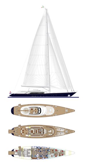

Very much an aside, but I suspect those headsails are generally only used one at a time.Tacking those three headsails must be quite a chore, but I suppose they don't tack often - too much risk of spilling the G&Ts
And are probably furled when tacking.Very much an aside, but I suspect those headsails are generally only used one at a time.

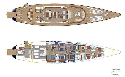

I purposely didn't directly mention the engine air vents because I have no idea if they are required for the air conditioning and generators to run. If they are even then I doubt sufficient water would have entered via them both in terms of volume and speed to overwhelm the vessel as quickly as happened. It's why I believe the rear sliding doors were the problem. They were unlikely to have been left open deliberately with the air conditioning but could have been opened by crew or passengers to escape or leave the boat. It's also possible that even had they been closed their weight could have caused them to open at the extreme angle of heel.Well that's undeniable, but some of the openings couldn't be closed with engines and ventilation going and they needed both.
Given what I've seen of the Italian justice system, I rather suspect that there may be a tendency to lean towards protecting the (Italian) builders.You are probably right. But what sticks in my mind is that the builders * immediately blamed the skipper/crew and claimed that the vessel was ‘unsinkable’ unless mistakes were made in operating it. Absolutely scandalous statement.
The primary victims were the passengers and crew member lost on that awful night. But the victims of the accident needing protection now are the skipper and crew. We’ll see if Italian justice can protect them.
* Giovanni Costantino
There are two 1m square openings for engines/generators/ventilation which are submerged at a tad over 40 degrees and can't be closed for all the reasons you hint at. They weren't open in error or for escape, they had to be open. I calculate one of those would let in 15pc of the vessel's total weight per minute if they were half a metre under. So there's no way that upside down this vessel wasn't going to sink once inverted with or without patio doors.I purposely didn't directly mention the engine air vents because I have no idea if they are required for the air conditioning and generators to run. If they are even then I doubt sufficient water would have entered via them both in terms of volume and speed to overwhelm the vessel as quickly as happened. It's why I believe the rear sliding doors were the problem. They were unlikely to have been left open deliberately with the air conditioning but could have been opened by crew or passengers to escape or leave the boat. It's also possible that even had they been closed their weight could have caused them to open at the extreme angle of heel.
WRT the engine room vents even if open with the engine room watertight doors closed as they almost certainly would be would there be sufficient volume of water let into the boat to sink her? I think probably not.There are two 1m square openings for engines/generators/ventilation which are submerged at a tad over 40 degrees and can't be closed for all the reasons you hint at. They weren't open in error or for escape, they had to be open. I calculate one of those would let in 15pc of the vessel's total weight per minute if they were half a metre under. So there's no way that upside down this vessel wasn't going to sink once inverted with or without patio doors.
But yeah, I fully accept that if we assume a quick capsize the 1m openings were not at the top of the list of their downflood worries.
