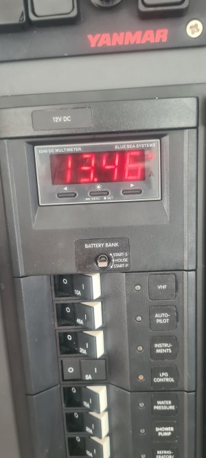

I think you don't believe how much a dunce I am when it comes to electrics. So to answer your questions, as best I can. I have 3 x 210Ah house batteries in parallel. I have separate start batteries for each of the engines and the generator. I have a Blue Sea Multimeter which shows Voltage and amps and is selectable to show the house and each start battery separately. I'm at anchor right now and each of the three settings is showing voltage above 13v - house and stb =13.50 and port 13.05 - but there are 2 x 70w solar panels feeding and it's a reasonably sunny day with minimal cloud. When I select the amp reading all 3 are showing 3.3 but truthfully I have no idea what that means.

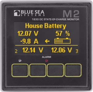

What exactly do you have?
One of these?
You meter shows the voltage readings for one of the three batteries according to which is selected by the switch below the display, as you already realise. Possibly the most useful readings will be when the batteries have rested with no charge or load for a number of hours ( ideally 24 hours.) There is a little table in the instructions to relate that reading to % state of charge but read the whole of the section for a full explanation. When the batteries are being charged by an engine alternator or by your solar panels you will see the charging voltage. When there is a load on the battery you will see the terminal volts which will be less than the resting voltage and will depend on the magnitude of the load.
There is only one current reading, it is not selected for the batteries individually like the voltage reading. Exactly what it is depends upon how the shunt is wired into the system. It might be the total nett charge/discharge for all the batteries combined , which it will be if it has been wired as shown in the instructions, or , if it has been wired in the negative connection to just the house battery bank , it will be the charge or discharge for the house battery bank. hopefully this is what it will be as this will be the more useful of the two alternatives.
When the batteries are charging the reading will be positive but when there is a nett load the reading will be negative.
