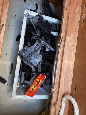

Here's what can happen if you create a spark near a gassing battery.
