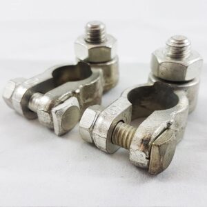

No real difference, but i prefer to use the threaded posts for everything, rather than clamps with studs on them (like below), one less joint.

Dont see why not, though in general I dislike the trad battery clamps so i'd avoid using them unless I had a good reason not to.
