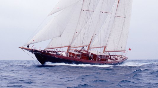

Schooners certainly are a glorious breed...I'd have no difficulty enduring reduced windward efficiency. And look at the bathrooms you get!
Admittedly, that bathroom is aboard the 2010 replica of Atlantic, around 200ft long.
Boats for sale France, boats for sale, used boat sales, Superyachts For Sale 2010 Classic Schooner - Apollo Duck
