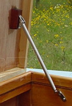

On mine the hatches are supported by cheap spring holders. Fine as long as you don't touch them (or just graze them by accident). There is no damping and they fall freely. Of course, far cheaper and easier to fit than gas struts.
I would like struts - but as I say the size of the floor panels do not allow them to hinge up like that - they hit the underside of seat frames / rear bench etc. They need to be lifted an inch or so and then slid to side - fwd.
