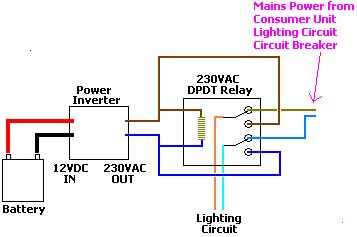

A simple and cheap solution would be a DPDT mains relay, with the coil connected to the inverter output. When the inverter is on, the shorepower would be disconnected automatically. When the inverter is off, the mains isn't connected to the inverter output. The following diagram came from Switch from Inverter to Mains Automatically | REUK.co.uk

I have done a similar automatic changeover using a similar circuit to that of pvb (#3) but with the shorepower connected to the 240V relay coil. Battery charger and water heater can be connected to the shorepower supply and not via the relay. When shorepower is on the sockets will be connected to shorepower. When the shorepower goes off the sockets connect to the inverter automatically and the battery charger and water heater will be off. This assumes you will have the inverter ticking over when on shorepower ready to go when required. If there is a remote switch on the inverter use a 3 pole relay and use the spare contacts to switch off the inverter or use the spare contacts to switch off any other high power devices.
Some sort of warning indication would be good so you know that the shorepower is off and you are discharging the batteries.
