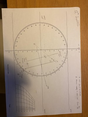

With regard to Charts, I create my own plotting sheets from plain A3. It’s 7 or 8 sheets stuck side by side for a typical east to west crossing. Easy enough to then plot the fix on to the Imray Atlantic Passage Chart, 100. Nice to see the daily slow but steady progress.
There can be long days during a crossing. What better way to pass an hour or so practicing the gentle art of celestial navigation.

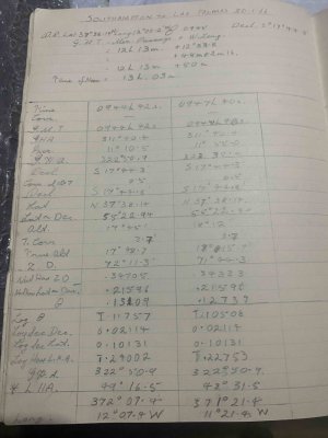

I had never handled a sextant before the day I took my first sight. OK I had an old vernier one from the 1890s given to me as a pup that my dad had picked up at the local auction rooms that I would play with in the back garden. But apart from that. A couple of years at sea, bound from 'straya to the UK. Cochin for crew change , Aden for bunkers. Now my father was a tanker master and his ship had called at Aden a week earlier. He landed his 1950 Plath with the ship's agent and it was delivered to my ship with much pomp and ceremony when we arrived.
First day at sea on the way up to Suez, 'here is an A5 sight book, rule it up thus, stand with me on the bridge wing, put lower limb on horizon and wobble it side to side a bit, when I say 'STOP' read altitude orf arc. Come into chart room and copy what I do with almanac and Nories'.
And that as they say was that.
I can teach any mug punter bright young man how to take a sight in a forenoon. Sadly most keep asking 'but why is it so??' That slows things up a bit.

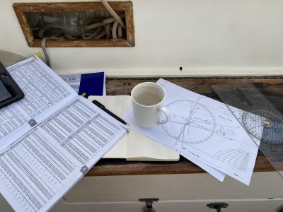

Hi, OP here. Back home from the aforementioned trip. Many thanks to you all for some great advice. We had a great trip, left Tenerife 11th November to get ahead of a big low which gave us the somewhat unusual start of 3 days beating down towards the Western Sahara coast. The trades kicked in near Cape Verde and we had a super ride with low seas and just enough wind all the way to Grenada, arriving on 1st December.
I took a variety of Astro nav literature advised in here and as well as reading it myself, shared it with my more learned mate. This was key as he could explain the bits that I struggled with. As advised by John Morris on here, we ended up using Tom Cunliffe’s book in conjunction with the full nautical almanac. We took loads of sights and spent hours reducing and plotting, and did get a buzz when the majority of plots agreed (close enough) with the gps track.
So thanks to advice from you guys, Cunliffe’s easy style of explaining, and my mate’s guidance, I have gained a basic understanding in a subject that initially seemed impossible to me. Thank you all.

I really rate Tom Cunliffes little book. Then I use the large imray plotting sheets which have good proformas on the back for noon sights and sight reductions. Then transfer the plot onto your nav chart of choice. I do a fair bit of astro as it helps fill the long days of a passage.
