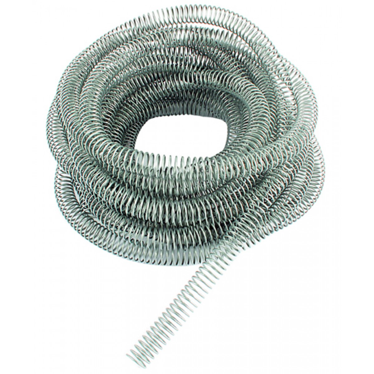

I've installed a normal gas hose, but covered it in an appropriate length of galvanized steel spiral for protection against crushing or getting jammed anywhere. This way you can still read the label and inspect the rubber.
Example (you'll probably have to find it elsewhere unless you want 10m of it): Galvanised Steel Spring Hose Protection

So now you've got a steel spiral to rub through your hose. Brilliant.
