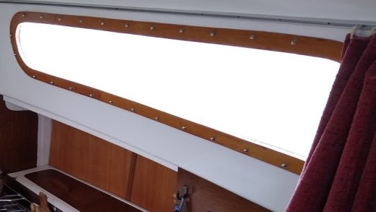

Interscrews need a larger hole than a. say, 3mm bolt. On Jissel, I used 3mm machine screws with domed nuts on the inside. Jissel (Snapdragon 24) wouldn't have been my first choice for off-shore cruising, but the windows wouldn't have been a concern.
With a 3mm ply trim, I don't reckon they looked too bad
Very tidy! I think it might be very tight for 3mm bolts but I'll remeasure on the weekend just to make sure.
