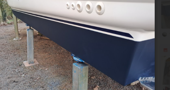

I used a 9 inch medium pile roller but didn't use the pole this time. A 4 inch foam roller and a brush for the fiddly bits .
Green frog masking tape
