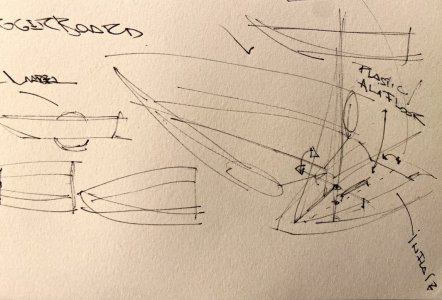

.....this sketch shows the kind of thing, maybe? maybe not? lightweight composite floor folds in half, inflatable sides holds beam for central support for windsurfer style main? Fabric transom or slotted in for rudder? left hand of sketch shows how offset dagger board slot could take large wheel (BMX mag wheel?) to counterbalance weight issues? just thoughts obvs......

"Modern" perhaps lighter DIY take on the Prout Coracle, I suppose. though if you can get a Prout for 100 quid you'd save time, money, and own a classic, all good things to do.
Other similar designs available on't site.
Prouts did an actual 10 foot pointy-bowed gunter rigged daggerboard folding sailing dinghy, (50 quid new to you squire,) called the Seabird which would sail a lot better than a Coracle, but I dunno if there's a modern take on that available.
That's looking an awful lot like a Tinker...
