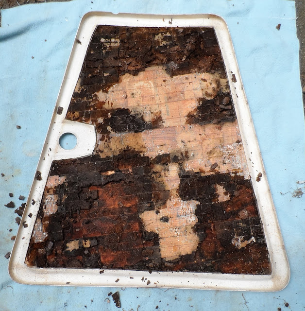

I've replace core before. if the space is full of water and balsa mulch, what is the glue superposed to bond to?
It doesn't make any sense on the face of it.
https://3.bp.blogspot.com/-DLzQY5vpvOY/WyF5bFf5poI/AAAAAAAAOv4/729SEdAfjCswsF6sMBDHF27esmG6-JNawCLcBGAs/s640/bad%2Bcore%2B2.jpg
http://sail-delmarva.blogspot.com/2018/06/bad-core.html
Thanks for the pics. Lucky it was only the hatch, I'm finding more and more leaks which seem to be brown in colour indicating rot. And with winter and rain here I think it will only get worse before I can properly tackle them...
