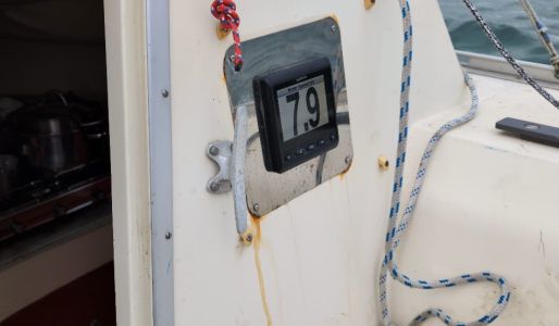

I believe I might now have the fastest Swift 18 out there (I have removed the shoebox shaped skeg which was a crime against hydrodynamics), faired around the keel root a bit in such a way that the keel still goes up and down, fitted a deeper rudder blade and fitted a slide in fairing for the keel aperture and a plug for the outboard well and it goes about 2 knots faster than it did... But I'd love to test sail it against another one!

Until this afternoon! And the first shoebox-less Swift! ( I imagine) Ok, my log is perhaps over reading a bit, but showing 7.9 knots through the water in 12 knots true, beam reach, under white sails only... Is NOT how it used to go before! With the same log, I never saw more than 5.8 before.
