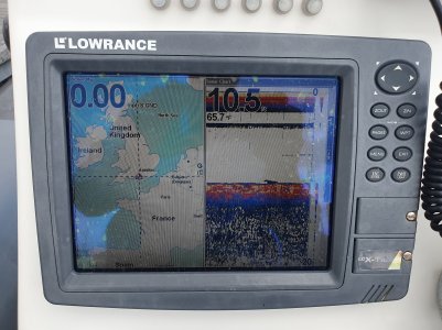

OK so my Rib has a Lowrance LCX-112c.
Yes I know its aging but it's really useful for speed and depth and its been great for a long time.
Yesterday it wouldn't get past its starter page when I switched it on, and then it just faded away to nothing on the screen.
Very odd, anyone know why, and crucially how I can fix it please?
Many thanks
Sorry for the poor photo, I took it really just for the model details, but this is the screen it won't get past.
Ribtecer
23 Aug 2006
2,109
Incase it helps anyone else, today I got to the bottom of this, and after some searching;
It was my Navionics chip, the contacts were covered in a solidified gel of I guess salt water and corrosion.
Anyway it cleaned up quite easily and is now working again. Problem is its now lost its setup, so I now need to reconfigure it. 😳20240826_121701.jpg
