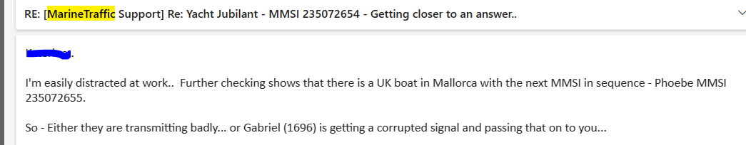

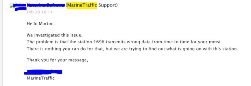

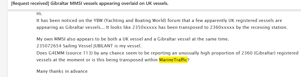

About ten years ago I found that my MMSI (a 235nnnnn UK allocated MMSI) was occasionally being shown on MarineTraffic at located at a berth in a marina in Mallorca. Over the next few days I then noticed that precisely the same location sometimes showed a Spanish vessel. Upon a closer look, all the last six digits of it's MMSI were the same as mine but the 225 prefix (for Spain) was occasionally being seen on Marinetraffic as a 235 prefix (UK) and thus showing as my vessel. From the website I could also see the receiving station ID.
In that case it was just one digit of the MMSI that was being sent in error to MarineTraffic. I logged a ticket with MarineTraffic via email and they checked and responded quickly.
Not long after that the inconsistencies stopped and MarineTraffic updated me again.
Correction to the above.. I just found the update I added to the Marinetraffic ticket at the time.
It wasn't the second digit that was wrong. It was the last.

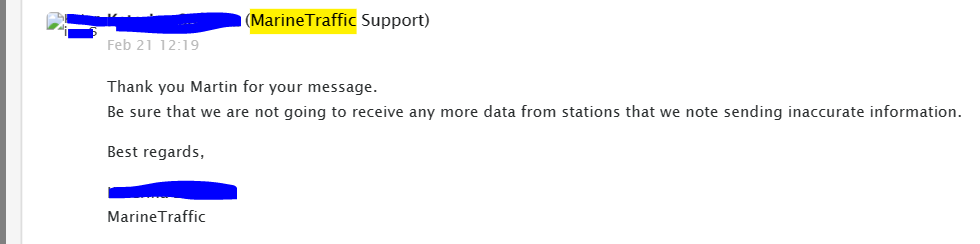

I have just found why I thought the country part of the MMSI was being incorrectly converted ten years ago.
It was due just eight years ago to a different receiving station converting the country prefix incorrectly (as noticed by a number of members here). Logged with MarineTraffic and shortly afterwards, the issue disappeared.
