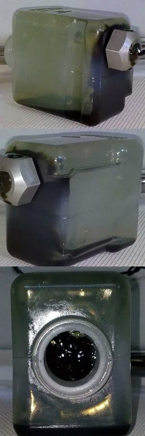

The drive was (boat now sold) a Bravo I XR, mated to a 496HO, and at the time I took the pics it was 3 years old but with only 100 hours or so.
Mind, other than the muddy deposit, the oil actually looked pretty good, not milky at all, and I didn't find any metallic bits when I changed it, so I can't say it didn't do its job.
But surely the bottle bottom did look scary.
Interesting, so for you this was muck coming out of the Quicksilver oil?
Absolutely, also because that was exactly the same thing which I found described in offshoreonly forum, which is where I understood also of the "green death" nickname...
I've not been on that forum a lot since I sold the boat, but you might find some references if you wish to google for that.
