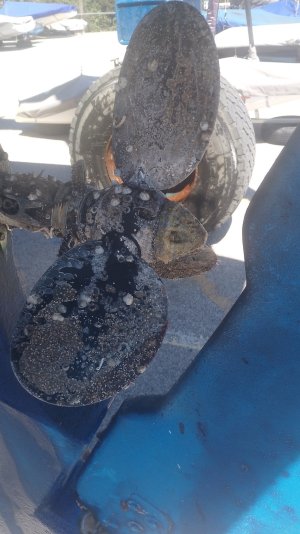

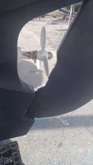

I have just done my Featherstream following Vyv's regime. obviously don't know yet how well it will work, but my last attempt used Prop O Dev both primer and spray top coat, but not a success. Patchy adhesion and poor antifoul where it did stick. However painting everything did significantly reduce anode wastage. Velox worked fine on the blades of the FlexOfold on my Bavaria. Photos show Ptop oDev after 2 years latest Velox
