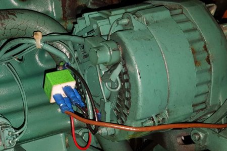

The relay on mine that stopped the winch operating until the engine was running can be seen below. The brown wire had been disconnected from the winch relay box by a previous owner so the winch now operates even if the engine is not running. I have subsequently removed the wire.As far as i've seen, the "engine must be running" thing just adds a relay that must be closed to enable the switches, buttons, remotes etc. The relay is activated by the alternator, when the engine is started. If you wanted to be able to use the windlass without the engine running, replace the relay with a switch (disconnecting or isolating the wiring from the alternator) the switch would normally be off, to prevent accidentally activating the windlass, turn it on as part of pre-departure checks.
