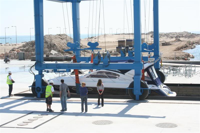

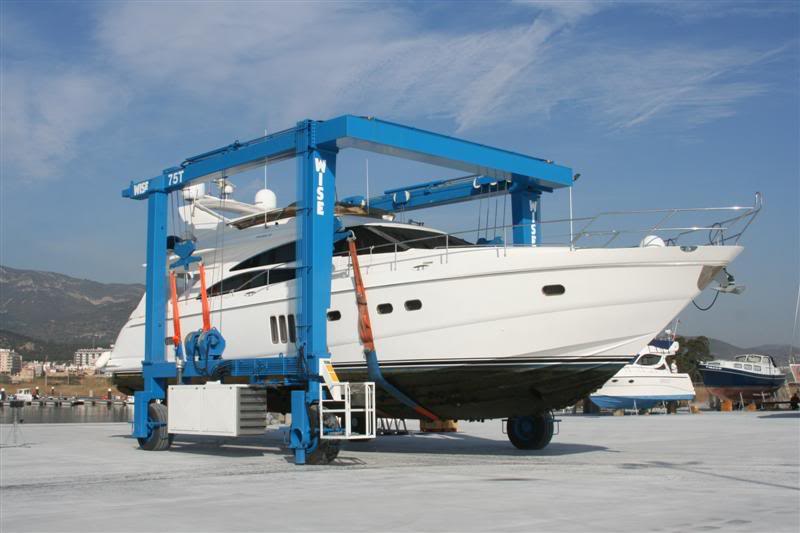

She only just fits in the lift bay

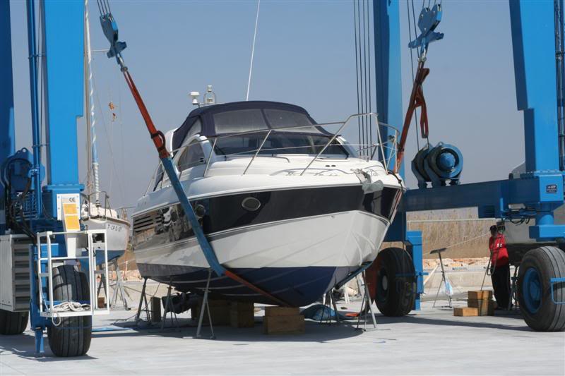

But safe once in the travel lift.

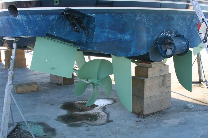

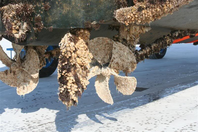

This seems to be what happens when you buy a new boat and transfer to her to warm waters without any protection. The factory gave her 2 coats of antifoul but we've done over 2000 miles in her since and there wasn't much left.

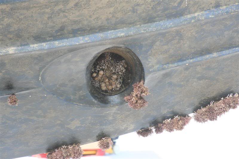

And no wonder that my thrusters didnt work - just as well that I didn't need them then!! - eh

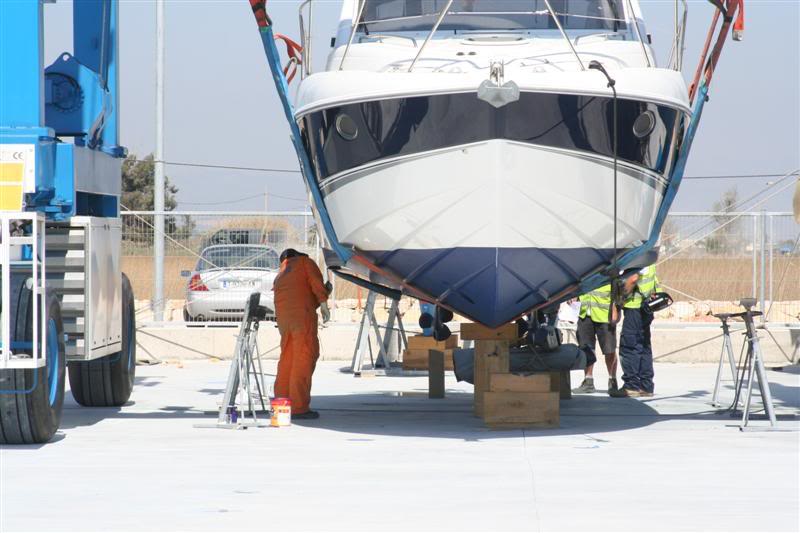

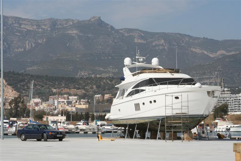

I'm now begining to realise the scale of her against my car. Also see how easy it is to work in this yard.

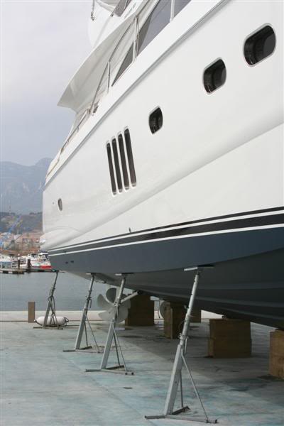

The wind blew up on Wednesday evening. So the yard manager popped out to ensure that I was safe and as a precaution, strapped me firmly down. They've fitted bolt down points throughout the yard for tis purpose. I've used several south coast yards but I'm really impressed with the attitude of the staff here.

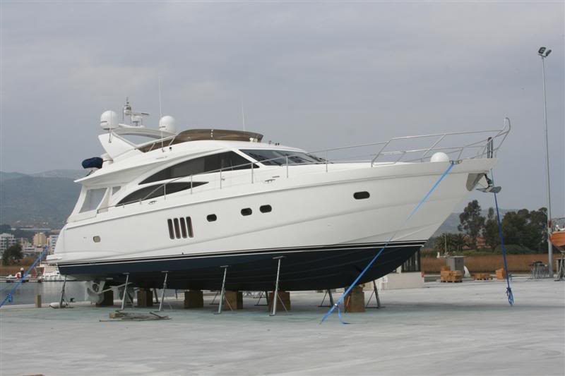

And later on, another forumite's boat gets ready for the plunge. Anyone recognise her?

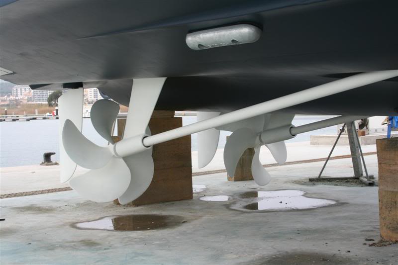

Meanwhile, back on JW things are looking up on the colour front.
This is the new Velox treatment - I'm not holding my breath but I've just got to try this out before I make any judgements on antifouling sterngear. I havent yet found a bad report on this treatment - in fact all the comments that I've found have been very promising. IMO the biggest battle is to get something to stick - then it must be strong enough to resist the agressive growth in the Med waters.
As far as I'm concerned, the jury is officially now out on this matter.
Anyway, after a week's hard graft, here's the final result.
I've even managed to find the time to get her completely A Glazed so we are now ready for the Med sunshine.
This pic jus about shows the highly glossy finish that we've managed to get.

Hi Mike, JW looks great. The growth in the bowthruster looked a bit terrifying - be interesting to keep an eye on that over the season and see how quickly it comes back. Maybe we need to build you a gizmo so that you can remote activate the thruster every now and then from the UK? Is the marina all wi-fi'd up now?
[/ QUOTE ]Actually the hull is not that bad. It's the undewater gear which is amazing.
Are you sure that they antifouled it at all? I suspect they didn't, or they did it very poorly.
In fact, the long trip could have removed the paint from props and rudders, but for what can be seen also both sides of the flaps and the two thrusters are in comparable conditions, whilst they should have been much less affected.

Your right - the factory didnt put any paint on any of the metalwork - standard thing at Princess I believe. The big problem for me was that they didnt paint the thruster gearboxes/props either so they became inoperable almost immediatly.

It appears the factory boys may have put on house paint!
You didn't want to try Prop-Speed on the underwater hardware? It works well in the tropical waters of Queensland (Aus)

Velox was the only one that I could find that didnt have anything bad said about it when I googled. Even thee forums have bad things said about Prop Shield.

Yep - the acid job first - thanks to the Princess guys in Banus, the name here in Spain is Agua Fuerte. Still lots of hard work to getthe props clean though.
Thanks also to djefabs who gave me some flap wheels to fit my angle grinder. That did the final job - in fact too well - they were starting to shine so I stopped and got the sandpaper out to roughen them up in readiness for the primer (green stuff).
