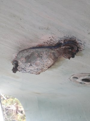

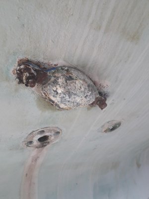

Hi,
Does this anode require to be replaced
Many thanks

Hi,
Many thanks
Hi, depends on how much time it took for the amount of wastage so far and whether you have good electrical connection to whatever it it protecting. I would be more worried about checking those fastening studs given the amount of corrosion
Plum
6 Jun 2001
4,534
UK East Coast
That is 2 seasons use - so 12 months in the water
Will replace the studs if replacing the anode
My view: If sure the studs are good and you have good conductivity from anode to whatever it is protecting then I would clean off the white stuff with abrasives (but do not use a steel/wire brush) and use it for one season.

Show the piccies to your local chandler who will almost certainly tell you to replace them, and happily relieve you of £60
