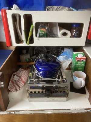

Mine has the minimum cabinetry and no seacocks/holes in the boat except the cockpit drains which I think is the right way to go with a boat of this size. Most of the time I move the cooker to the cockpit to use it and the only reason I would cook below is to get out of the wind.

...but I'm 100% with you, regarding cooking - it doesn't belong indoors except in the worst weather, and a fixed galley unit occupies more space than it warrants in a tiny cabin. I decided against the Swift 18 mainly because its galley-mouldings dictate the layout of everything else in the cabin, but cutting them out will hammer the resale value.

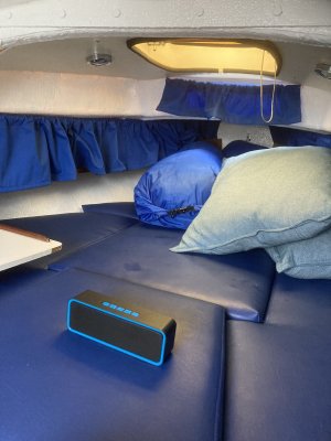

On my own boat I've got midship galley and sink - now converted to a bookshelf - and I've infilled the forepeak to give an adequate triangular double berth. I find the trotter boxes claustrophobic so they're relegated to sail storage and a slide-away chart table.
