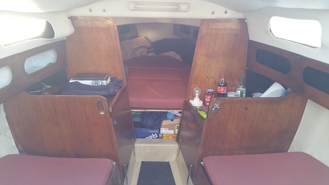

In the Achilles (which I describe here because in form and scale I think she is very similar), I felt that even for two not-very-tall, not-very-fat people, the use of 30 inches of the under-cockpit cavity as leg-space to justify shortening the sofa-berths, made the small saloon feel unnecessarily cramped. The berth-ends had been consigned to trotter-boxes in order to allow biggish wooden cabinets with useful shelves at the forward ends of the saloon space.
Had I kept the boat (and had I first fixed the hateful headlining) I believe I would have ditched the cramped V-berth forward, moved the shelf-cabinets into the V-berth space, leaving loads more netted/free stowage in the bows...
...and meanwhile, I'd have made the two sofa berths into properly comfortable places to sit (complete with forward and aft backrests for lounging, feet up) and to sleep, convertible to a generous double if we so chose.
I'd have made and fitted a sizeable, sturdy folding table too.

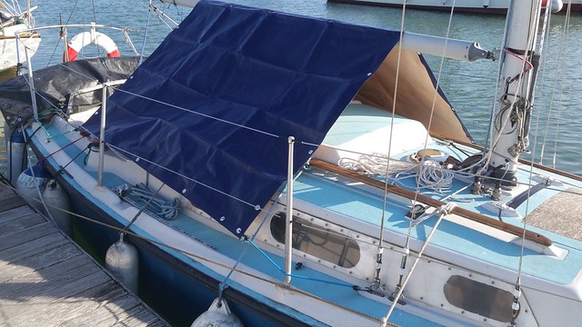

Personally, I found it preferable for all kitchen and bathroom business to be carried out in the cockpit. The rain-proofing and privacy provided by the simplest boom tent mean the saloon could be kept as a clean and comfortable space, unpolluted and uncluttered by steam, stinks, stoves and spattering fat. It staggered and repelled me, that plumbing had been provided for a sea toilet in the Achilles' tiny fo'csle.
I concluded that the challenge inside either the Achilles or the Corribee would be to recreate a cosy Shoal Waters-style mini-cabin, benefiting from the relative roominess of the otherwise minuscule accommodation in both these yachts. The most important principle seemed to me to be jettisoning the respective designers' original intent to provide berths for more than two people; and any domestic complexity other than really comfortable sofas/beds.

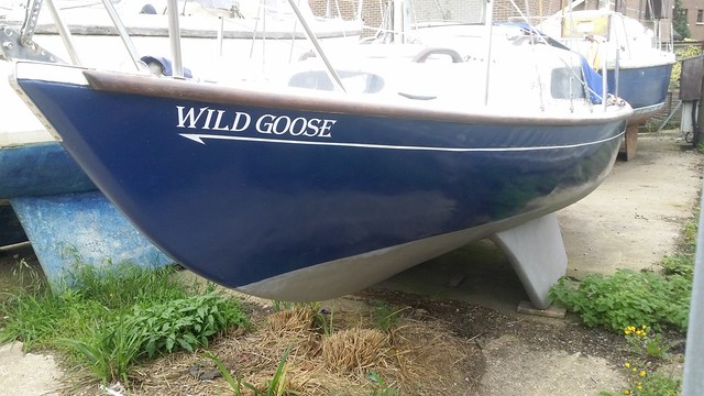

My photo in post 25 above, of Wild Goose seems to show how very shallow-draughted the bilge keeler is, and I wonder whether she's proportionately tender as a result, or little different from the deeper fin.
Re the bilge keel, tbh I’m not feeling much difference from my long keel wooden boat. Certainly the coribiee sails as close to wind as old Paean did. Slightly lower freeboard so slightly wetter, but not much.
