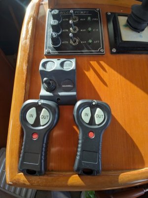

Just out of interest I've just fitted a remote control to my Maxwell Anchor. The entire cost of the project is just under £11. Two remotes that can be switched on and off and the range of the remote is way further than I'd ever need. To me this is a no-brainer for a simple solution..

Well done. Is there a delay when you press either direction button?

I like those remotes. Where did you get these from please?
