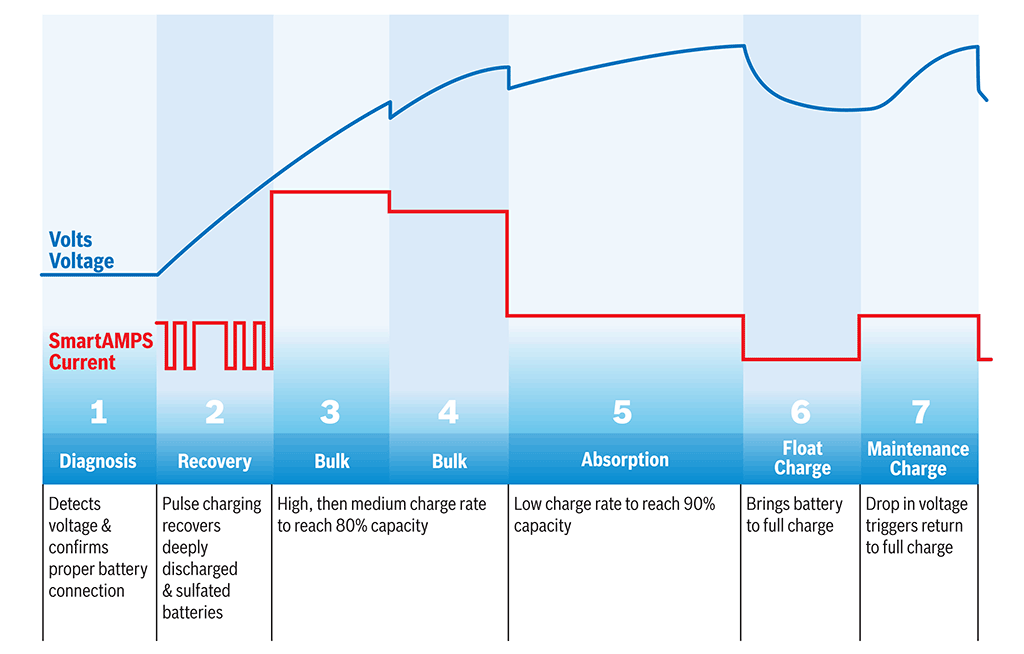

As a rule of thumb the charger should be at least 10% of the battery capacity - in your case 7.5 A if charging one at a time.
For all intelligent chargers (runs throug a number of stages, time depending on battery state) it is important that you allow it to complete the stages.
As an example - 7 stages:

The charger i have has 7 stages, but never seems to get out of the 2 amp stage. But i have just read the customer reviews for it - a halfords smartcharger 100. Wish i had read the reviews before buying it! Agree with all of them.
