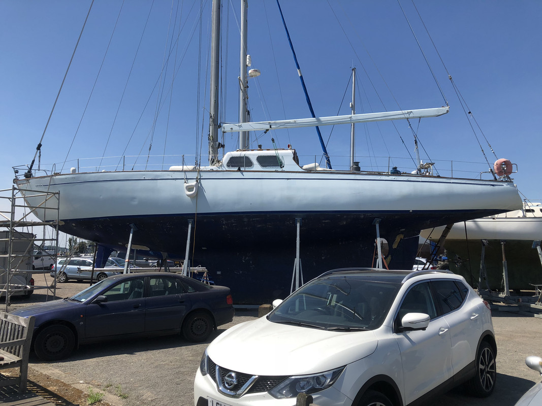

You don't say what your budget is likely to be or whether you are in the market now, but it might be instructive to look at an Italian built Giles design 60' aluminium hull ketch for sale in Poole. Looks a bit tired but from what I could see the hull is excellent.
Details on www.preciousmarine.co.uk This seems to be a listing agency rather than a conventional broker but there is a detailed description and photos. Boat is very accessible in the water at Cobbs Quay.
Unusual to see a boat of this style and quality in the UK so probably well worth a look.
