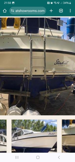

I have a Broom Ocean 37, stern berthed, and rear boarding via a boarding ladder.
My issue is to get my elderly father on board there is too big a step between the top ladder rung, and the deck for him to lift his leg.
Ideally I thought we could add a single bolt on step to the rear fibreglass, approx half way between the top ladder rung amd the deck.
Sounds simple, however. The boat we have was a special build with an additional long range fuel tank in the stern.
This means we can't get behind to put nuts on the bolts.
Would anyone know is there such a fixings similar to those used on plasterboard walls, bit stainless which we could solidly mount an extra step with without having to access behind?
I've attached a photo of the rear of the boat.
Thanks for any advice or help
