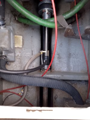

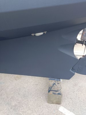

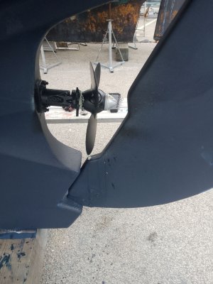

Having a steel boat Zinc anodes do protect mild steel where there is 2 different Matals that are electrically connected and imersed in an electrolyte (sea water)
i HAVE ANIDES ON MY MS hull and MS rudder but do little to protect from galvanic corrosion and does nothing to protect from rust.
My hull was grit blasted and painted with 2 coats of epoxy primer and 6 coats of epoxy tar before anti fouling.
I have NO yellol metal below the water line so very little in galvanic corrosion, I have 316 propeller, prop shaft and rudder shaft all insulated with plastic bearings / bushes
