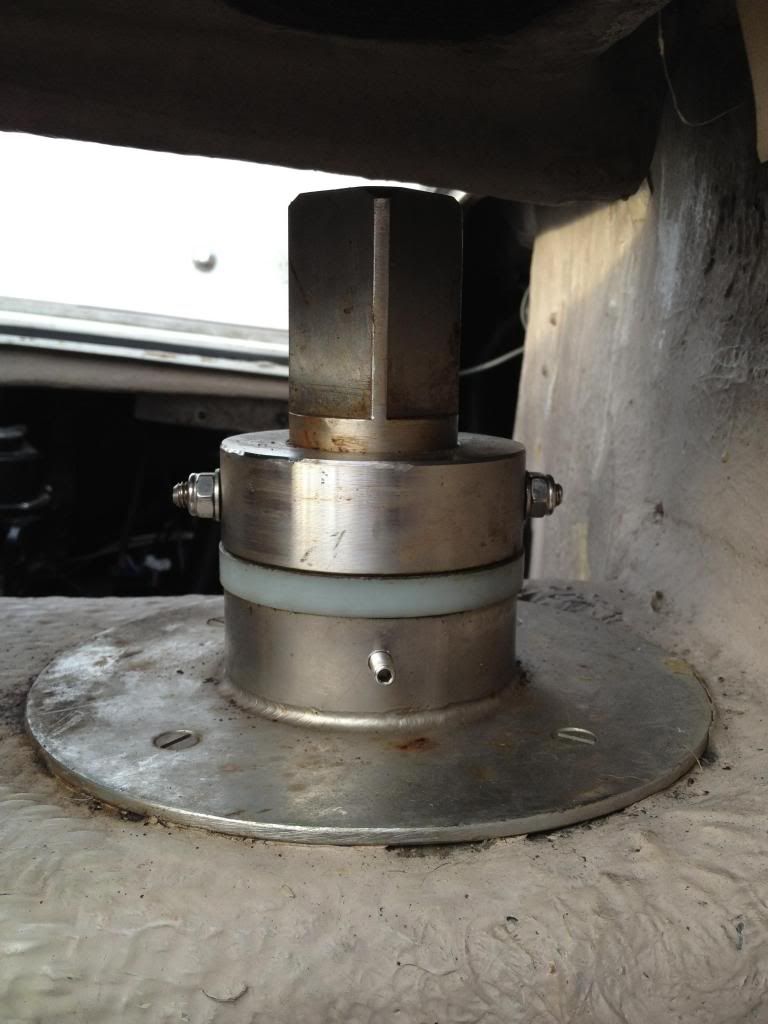

I have a ufo27 with a spade rudder which I am trying to drop. I need to do this for prop shaft removal,for cutlass bearing replacement
the boat is out of the water. I have removed the tiller and tiller bracket. I have also removed a screw with screwdriver head on top, also a pin that goes through the rudder shaft at the top, also 2 grub screws that were going in at the side presumably also securing the square at the top of the shaft . I was expecting the whole assembly to drop at this point. I have given the top of the shaft some hammering down and nothing drops.my concern, is there something else to be removed or is it a matter of more forcefull persuasion with the hammer
