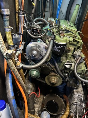

Appreciate this is an old thread but have just bought the recommended Parts 4 engine alternator for my Volvo Penta 2003 (this is the insulated earth though so had to add another heavy wired connection back to the battery) did you have any issues with the fan blades rubbing on the adjustment bracket and if so could you suggest any adjustments? Many thanks
I had no difficulties at all, once the pulley was persuaded to come off the old alternator. I just tried to look up the part number I got, but unfortunately Parts4engines doesn't retain order information.
I just tried to imagine it, but I don't see how the fan blades can rub against the adjuster stay. On my engine they aren't even close to each other.
