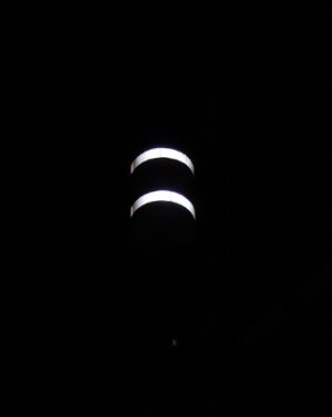

Steaming light (though if under 7m(?) your mast-head anchor light will serve as a combined steaming light and stern light).
Agree mast-head tri-colour, but as an addition to your existing masthead anchor light. (I value having a masthead anchor light, if only to have on while I'm getting checking I'm not dragging after anchoring, getting sorted and then rigging up a 'portable' anchor light above the deck (fore or aft).)
(Plus a crew that understand which are and which are not acceptable combinations of lights in which situations, alternatively a rotary switch that only allows the relevant combinations, and indicates which are for sailing, steaming, anchoring, etc.)
