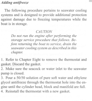

A 'trick' that the 2GM ' 3GM (and I cannot see why not for 1GM) for long term in real cold goes a little further .... if raw water cooled ...
After draining via the drain cock on the block ... open up and remove the thermostat ... now pour in Antifreeze and watch for it exiting the drain cock .. once Anti-freeze seen - close the drain and pour in a good measure of Anti-freeze .. replace thermostat and cover.
Of course the intake needs to be drained ...
This was heavily promoted on Cruiser Forums and others ... and I have to say - it makes sense ...
No doubt some 'expert' will now tell me that's wrong ... well go check it out ...

Here's the info from the Shop Manual that covers all 1 - 2 and 3GM models :
As I said before - I don't fill so much .. bit wary of overfiling ...

Wjhat about Yanmars Manual that says ... remove Thermostat .... open drains .... pour in AF to thermostat housing ... close drains ... fill via thermostat housing ?
I did that with the 2GM last year and we have temps down to -25C or lower ...
Yes I did pour in AF to the big inlet water filter and had engine pull that through bypass and exhaust before doing the Thermostat option.
