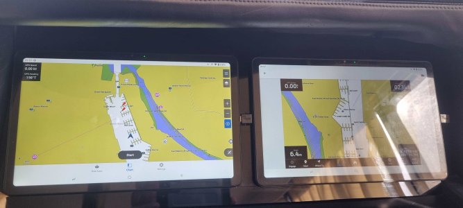

The screen on the right, below, is a mirror of my the plotter on the flybridge of my own boat. The screen on the left is running stand alone, using the internal GPS of the tablet, it's mounted at the lower helm, beneath the flybridge.
Spot the difference ?
