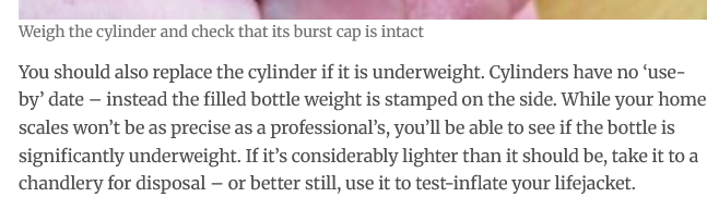

CO2 cylinders are classified by the mass of gas contained. Most LJ cylinders contain 33g of gas. Weighing is a valid check on the integrity of a cylinder.

Thank you awol. Its just amazing that nowhere on the internet can i find this information,and i have spent hours searching. Now all i need is some official confirmation that the stamped weight includes the gas. I would have thougth it does, but making assumptions is risky

If you don’t already know this I’m not sure you should be modifying cylinders! However the weight embossed on the cylinder IS the weight after it has been filled with CO2, you can (and should) check this with a good set of household scales. Painting it will add a little weight but presumably not enough to be material - the difference between a full and an empty cylinder is noticeable.

found of all places ,on a life jacket Safety Data Sheet !
HAZARDS IDENTIFICATIONCO2 Cylinder ::The inflatable lifejacket contains a small cylinder of compressed CarbonDioxide CO2 gas that may vent from the cylinder or inflate the life jacket.The cylinder may explode if heated, or under fire conditions.CO2 is non-toxic, non flammable and heavier than air. In highconcentrations may cause asphyxiation. Cylinders contain 33g, 38g or amaximum of 60g of CO2 gas.
then this on an airlines website
Dangerous Goods Documentation
The 50ML rule does not apply to lifejackets, however for info a 33g cylinder which is most common in adult lifejackets contains 46ML of liquid Co2
Thats a massive difference ! I would go with the Safety Data Sheet. From my past experiences with fully inflated jackets i wouldnt be concerned for myself if a cylinder was fractionally underweight, as a fully inflated jacket is a full in your face experience.
