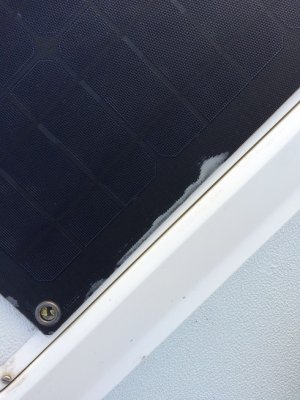

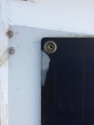

I’ve got no axe to grind and my eyes and ears are reliable sources of info as to what I’ve seen and heard. I’ve actually got a lot invested in ETFE panels and wish they were perfect, but I know they are not. There is no FUD. They are simply not as reliable as good glass panels, but they are better than PET and cheap flexible panels.

Ok, photos taken perhaps after about 6 months and continued to get worse, though the panels did still work. Panel mounted with 6 velco circle pads.
